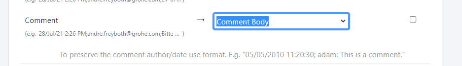

With regards to the comments, In the mapping step, I get an option on where to place the comment in the imported issue, but Comment Body, is not shown as an option in the JIRA list.
If I type in Comment I get 'No matches':
Thanks.

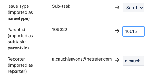

@mfabris , with regards to the sub task,
Issue type and parent id are mapped:
The error I get is:
  • Subtask '10015' doesn't have a valid Parent Id selection. Issue will not be created.
thanks
Aldo Cauchi Savona
July 30, 2021
Hi all, spoke with a JIRA consultant, who recommended that the import is done via the Admin > External Import. On doing this, the comment body showed in the field mapping options and was successfully imported.
With regards to the subtasks, the story was imported first. The in the subtask CSV, the parent ID was changed to the new issue key (like NRMA-5) and the import succeeded along with the correct subtask parent being set.
