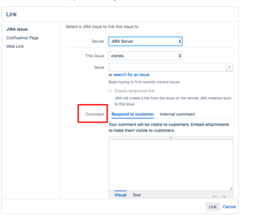

I think you can utilize the comment field while linking issue. here you can describe why you are linking these issues.
kindly accept the answer if it resolves your issue!!

Thanks for th quick response, but unfortunately it does not solve my issue.
The information I need to give is not associated with the issue, but with the link. It gives additional information about the link of issue A to issue B. I also need to query this information in connection with the link (queries like "find all issues with a certain link type to other issues and display this additional info").
If I use a comment like you suggested, it will solely show up in the comments section of issue A. It has no logical connection to the link (taking about the Jira object).
