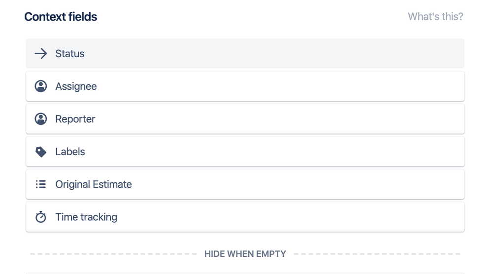

I have added a number of fields as context fields, 'Original estimate' & 'Time tracking' yet they are not appearing on any issue so we cannot add time estimates to any of our issues whether they are in the backlog or SFD.
Please can someone help out here? Anyone experienced the same issue?

I have this field as an option and have included it by editing in the 'issue layout' tab.
image.pngbut it still isn't showing on any of the issues on our board.
Like Ansar Rezaei likes this

time tracking is a built-in Jira filed and when you add it to your screen you have both Original estimate and remaining estimate field.
The previous comment about seeing and editing the field on the issue page. If you want to see a field in card view on boards you should add them from board configuration as follow:
  1. Click the Jira icon (, or ) > Projects > then select the relevant project.
  2. Go to your Scrum backlog, Active sprintsKanban backlog (if enabled), or Kanban board.
  3. Go to ••• > Board settings and click Card layout.
  4. Add or delete fields as desired.
You could find more detail here.

This all makes sense. Thanks Ansar...the issue is that I have added it to the cards as a field, regardless of whether it is empty or not, but it just isn't appearing on a card.
It appears in the card layout, as you explain above but yet still not displaying.

Yes, @Ansar Rezaei was able to help me solve this. Bit fiddly to find the right screen to enable this.
Our project is a 'Software project', you need to go to Jira settings > Issues > Field configuration.
Then from here you need to scroll down to find 'Time tracking' and ensure it is enabled so that it displays on your tickets.
Hope that helps!
