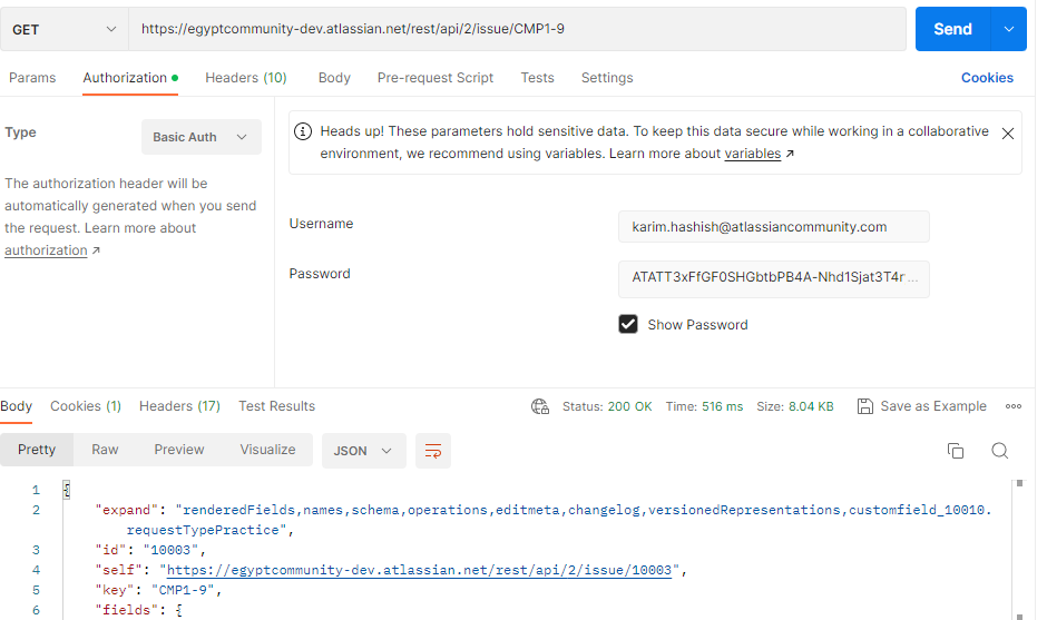

hi @sindujb
I'm not an expert with dart but i suspect that you have an issue with the authentication part.
I'd suggest the below steps
  • Please test your connection with the right parameters using postman
  • For connecting to JIRA API you need to create API Token first then use it for the password and your registered email as the username.
  • you may use this link to create your API Token
Below is an example using postman. hope that would help
Let me know how it went for you.
Cheers,
Karim
SCS user
May 11, 2023
I struggled with this FOREVER.....and thanks to your answer, I figured out I had to use the API Token as the password.  Thank you!
