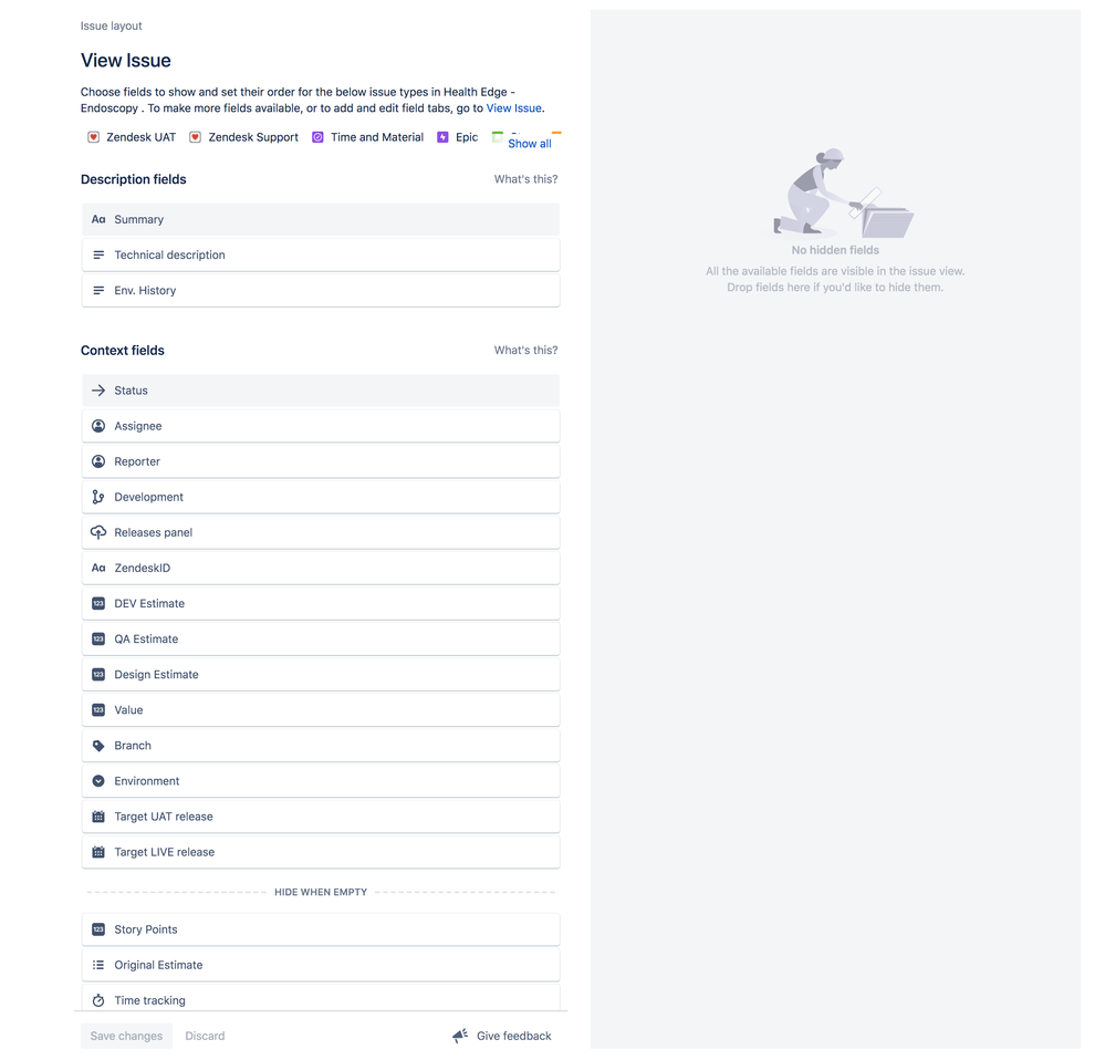

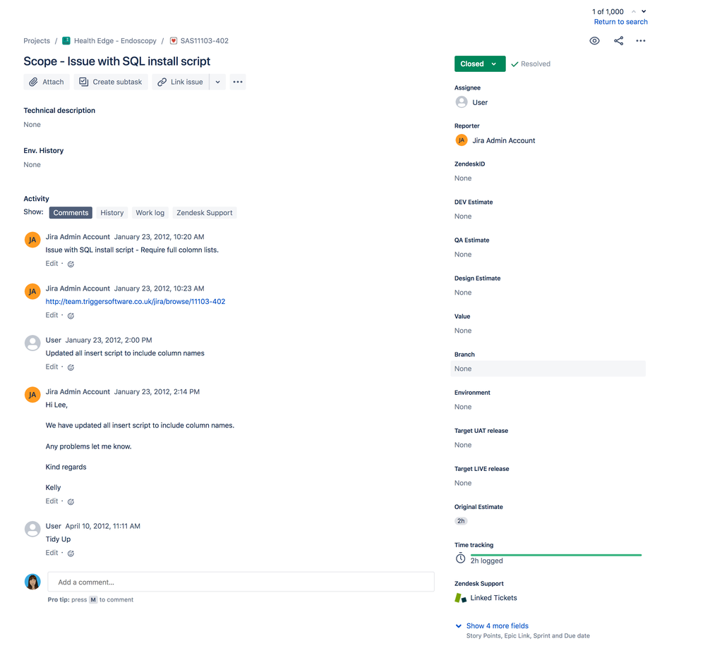

Liz
March 31, 2020
Hello @Petter Gonçalves we are using a classic project. We are working on migrating from Jira server to Jira cloud. We have run a test migration and are now testing we can do all the same stuff.
Please see screenshots attached.

Liz
January 4, 2021
As an update, I believe I might have fixed this. The issue appears to be that I didn't not have (no idea why) "Description" as a field in the "View issue" screen configuration.

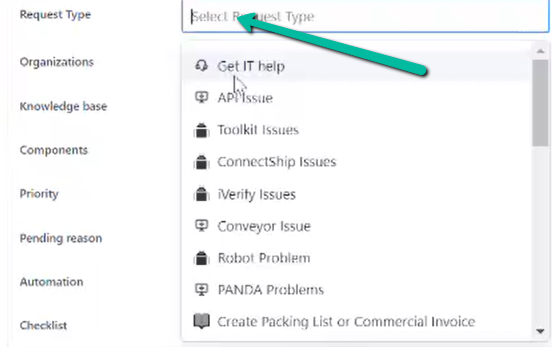

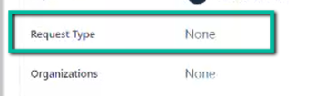

Miriam Hopton
October 14, 2021
@Lin-Hao Chen When it copies to the other project, the request type is blank. Click on the Request type field and pick the appropriate one:
1. Null Request Type
2. Select the Request Type (to fix)
See the first attachment "Request Type_None" and the 2nd picture  "Request Type_select value", illustrates selecting the value to apply.
