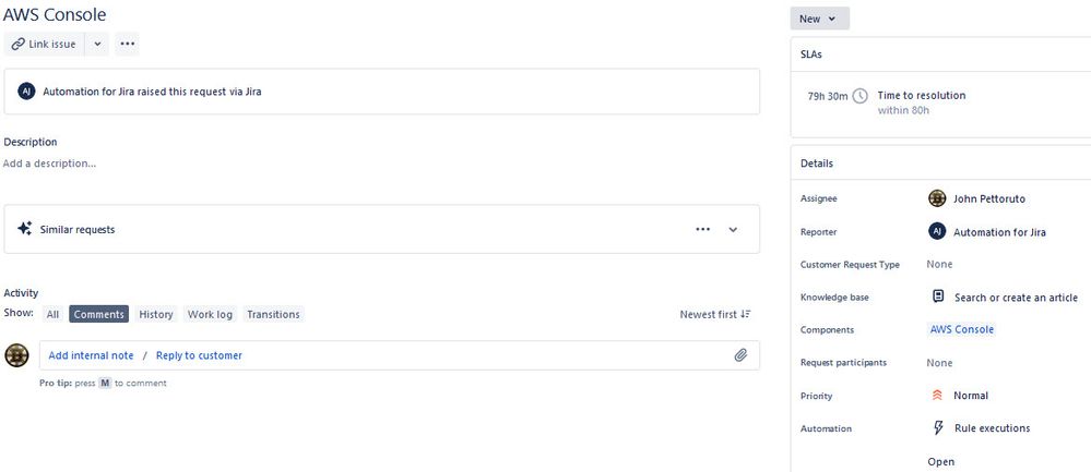

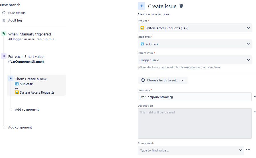

The below is now creating subtasks off of the components. But is it possible to have the component field itself copied/set in the sub task? I cant seem to get that field copied over from the original and subsequently set on the new sub task created. Ideally I would like the end result to look like screenshot2 but I had to manually set the components field and assigneesubtask.jpgscreenshot2.jpg

John, in the create issue action, you should be able to enter the smart value for the Component field.  The "trick" is:
  • select the Component field
  • type in your smart value, such as {{varComponentName}}
  • as you type, it will appear below the field
  • select that displayed value below the field, and now the smart value will be used to populate Component

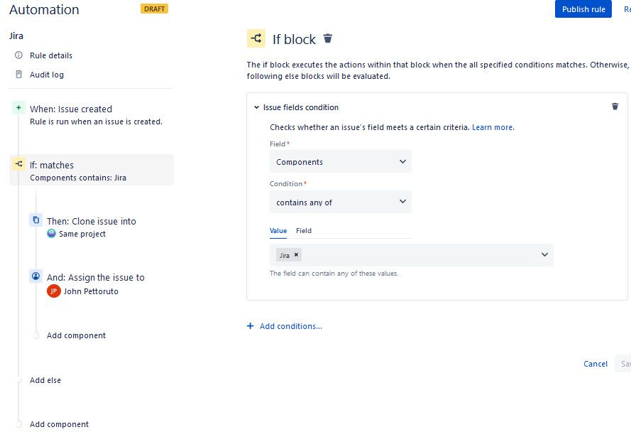

Here is what i have so far. the "components" field are the systems that trigger each ticket to be broken out into separate subtasks/clones and assigned to the designated person. In this scenario, i'd have about 5 other automation rules for each component/system. I have not found a way to build all components into a single automation rule. Thanks for your response!
