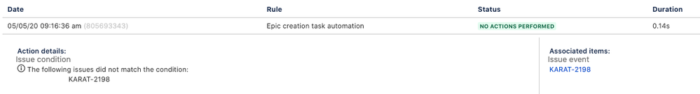

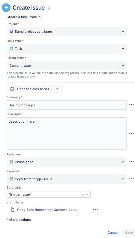

Actually, I'm back! running into issues with another rule I tried to create (creating an epic should automatically create a task with the IF statement Epic issue assigned as the parent of the THEN created issue). Here's the automation rule and the audit log error I got.
 Screen Shot 2020-05-05 at 9.20.25 AM.pngScreen Shot 2020-05-05 at 9.21.26 AM.png
Audit log after I published the rule and created an Epic expecting a child task to be created automatically.
John Funk
May 5, 2020
And you are sure that KARAT-2198 is an Epic?

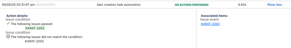

Irena Lam
May 5, 2020
Hm it's passing the first condition (if project = ABC) but not the second condition (if issue type = Epic) even though the issue I created is an Epic.
Screen Shot 2020-05-05 at 3.10.24 PM.pngScreen Shot 2020-05-05 at 3.10.42 PM.png
John Funk
May 5, 2020
Sorry, I lost track of the original discussion - the problem is that Next-gen does not currently handle Epics in the proper way like Classic projects. That is why it is failing to recognize the Epic.  :-(

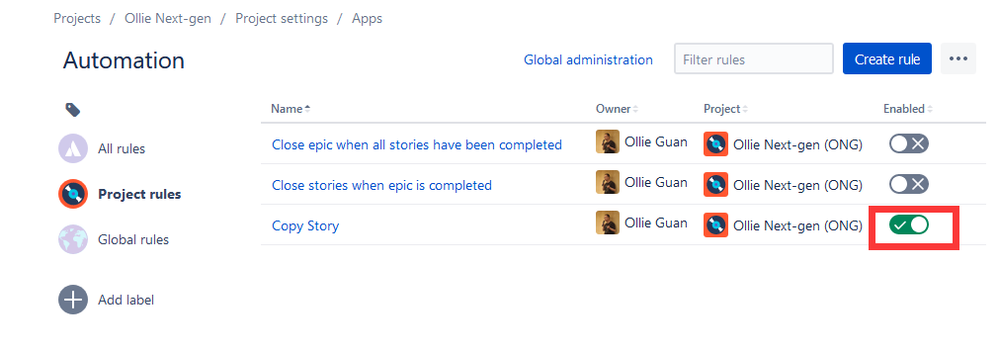

Ollie Guan
May 5, 2020
Hello @Irena Lam ,
I tested the same conditions and it is effective in the next gen project.
Have you enabled it?
BTW: Are there any differences in the field settings between your Story and Task? For example, some required fields and so on.
