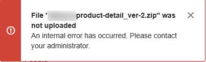

Hello,
I've set max file size for uploads up to 100 Mb.
I'm trying to upload ZIP archive on 30 Mb, but having an error:
Culd you please help with looking for the possible causes of this problem?
Thanks!

In this case I would check the logs as that error does not provide any clues as to what the issue could be at this time.  I would also check the following:
  • Does this happen to more than one user?
  • Does this happen on another network?
Reproduce the issue and post the log snippet from that time and we'll check it out and see what's going on.
