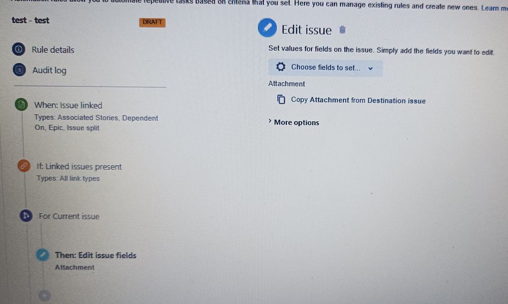

Use Case Here : i am attempting to auto attach content to an Epic from its associated linked EPIC.  I implemented this in two ways :
1. Implementation 1 : Screenshot attached
Trigger : Issue Link
Action : Edit Issue --> "from- Destination Issue"
this method is working as expected

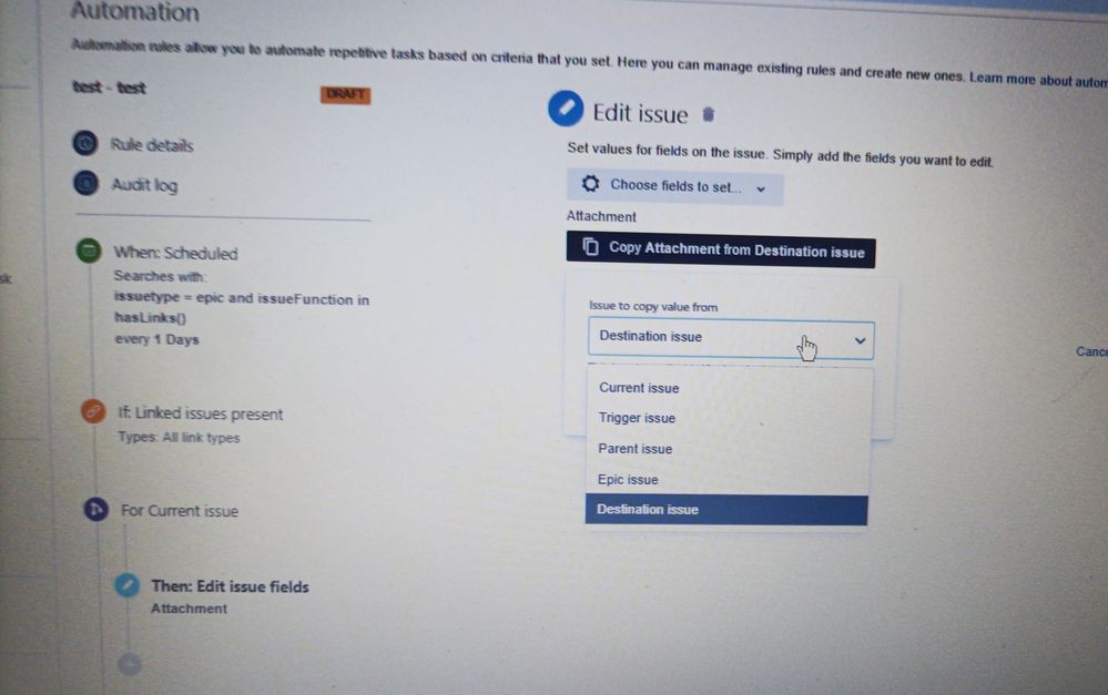

2. Implementation 2 : Screenshot attached
Trigger : Scheduled
Action : Edit Issue --> "from -_ _ _ _" (tried all options)
This method is not working at all. Attached the audit log as well. Audit log does say successful for one of option, however, attachment is not happening for the parent epic.Implementation 2.jpgImplementation 1.jpgaudit log.jpg
Need some guidance in implementing method 2

Unfortunately, the smart value and concept of "destination issue" only exists when the trigger is Issue Linked or Issue Link Deleted.  That is why the copy does not work with other trigger types.
For your scenario with the Scheduled Trigger using JQL, you could instead invert the JQL so the "trigger issue" is the one with the attachment, branch to the linked issue, and then copy attachments from the trigger one.

Resolved it as follows:
  • scheduled trigger: with JQL to find the issues that have the attachments you want to copy from : (issuetype = epic and issueLinktype = "is associated to) and labels = xxx
  • Condition : Compare two Values : {{issue.summary}} contains {{triggerissue.summary}}
  • Branch rule : Linked issues - Link Type : "is associated to"
    •  Condition : Issue Filed Condition :  Labels Contains any of  "ABC"
    • Action : Edit Attachment Field : "Copy from Trigger Issue
