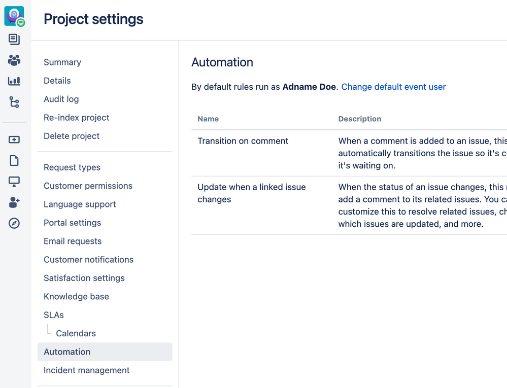

I did work on a case recently where no one could figure out what was taking a certain action and in the end it was caused by JSM Legacy Automation, on this screen:
If you do have Automation for Jira plugin (which is different than the above), make sure you check both Global and Project specific rules.

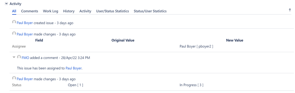

@Filipi Lima I have checked in both the JSM Legacy Automation and Automation for Jira plugin settings, but do not see anything relates to the assignment of the watcher to my test issue.
In the issue history, all I can see is that the "FMO" user is adding a comment. This "FMO" user is the subsequently set as a watcher on the issue. However, even the history doesn't provide any insight as to how that is happening.
