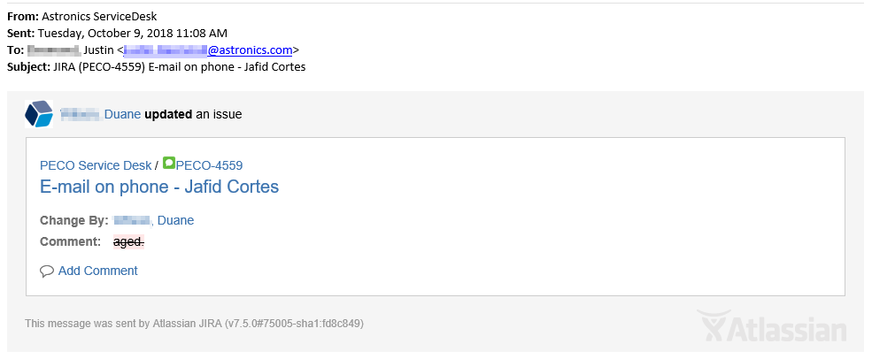

I have done that as well but just noticed that the e-mail format is the same when it says "Updated" but rather, it's due to a comment being deleted, which is a separate notification type. I think I've solved my problem.
Example:

Francesco C
October 9, 2018
Also checked the workflow (this is for multiple issue types/workflows) and there is nothing in Post-Functions or otherwise that indicates a notification should be sent. The notification received also follows the exact format of the "Issue Updated" notifications we see for folks in the group that should receive them.
