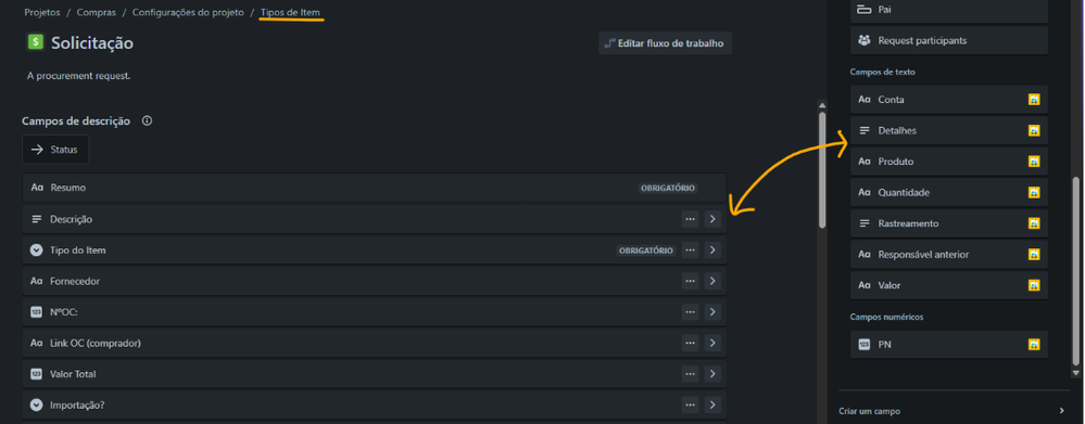

Raynara Alves Blaque
April 10, 2025
Hello,
We are using Businness Project, managed by team.
I just removed the field here, in the project configuration -> issue type.
However, when I put it back, it doesn't haven't the same content.
Trudy P Claspill
April 10, 2025

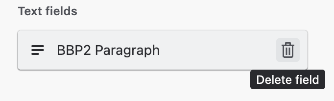

After dragging the field to the column on the right did you at any point click on its Trash Can icon to completely delete it?
That would delete all data that had been stored in that field also. Creating a new custom field with the same name would not restore the field.
If you did not fully delete the field, how long was the time frame between when you dragged it to the column on the right, and when you went back and dragged it back into the issue layout on the left?
I just did some testing in the same project type with the Short Text and Paragraph custom fields. I added them to the issue type and saved the change. Then I added data to the fields in a specific issue. Then I dragged the fields out of the issue layout and saved the changes. I viewed the issue again and confirmed they were no longer displayed. Then I dragged the fields back into the issue layout, saved the changes, and looked at the issue again. The data I had previously entered into the fields was present.
I have not been able to recreate your experience of the data being deleted, but we need to confirm that I was following the same steps as you.
April 11, 2025
Oh my God, I can't belive it! It worked now.
Being truly honest with you, I know I didn't fully deteled the item, but I don't remember draggind it back to the layout and seeing if restored, because I panicked and when I asked chatgpt, it said there wasn't any way to restore.
As I was desperate, I just focused on the new cards trying to find the info I've lost.
Thank you so much for your help!
