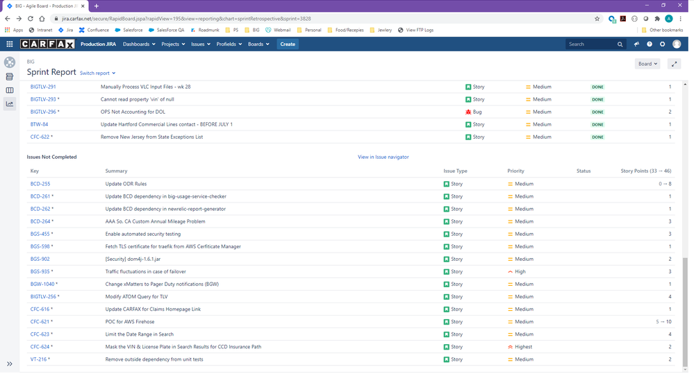

One of the users in out company was going through their sprint reports and found that the status of issues completed is not showing up.  Most if the report have statuses but some issues do not.  In this case none of the issues had a status.  I do not see an explanation if I drill into each issue other than the current status is now Done.

Hi @Brian Taylor
Please check the board configuration and see if all the statuses are mapped to the columns.
