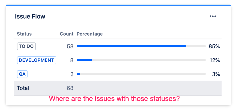

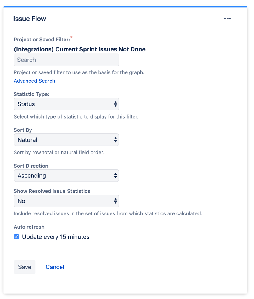

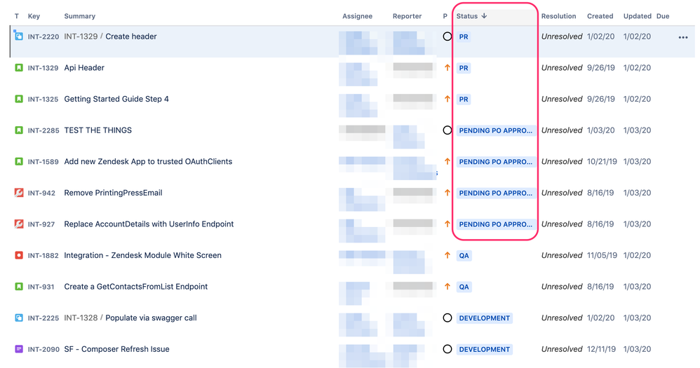

Hi there!
I'm using the Issue Statistics gadget in some team dashboards. It seems to be inaccurate, though. I could be missing something in the administration of Jira or set-up of the search that powers it or in the gadget itself. Looking for a little help here. Thanks!
My goal is to highlight bottlenecks in the flow of issue during a sprint. So, I'm showing how many issues are in each status (Development, QA, PM Approval, etc) at any given time.
The trouble is I have issues returned in the search results that are not showing in the gadget - at least not with the expected status.
I've attached 3 screenshots to help explain.
  1. Search results
  2. Gadget settings
  3. Gadget results (I renamed it Issue Flow)
Any ideas on how to resolve this?
Thanks in advance.

Check whether the JQL you are using in the issue statistics gadget is correct.
As of now you are using "Current Spint Issue Not Done" JQL Filter, can you share it.

I have the results I want in the search. The problem is some are not showing in the gadget at all. For instance, PR and Pending PO Approval are 2 statuses appearing in the search results, but not in the gadget that is using the search results.
