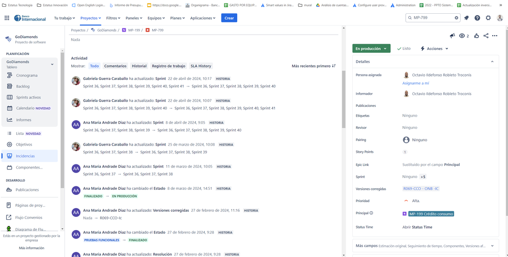

Why does the issue keep moving from sprint to sprint if its status is already "En producción" (done)?

For a Scrum board, when you complete the sprint only the issues that are in the column farthest to the right will be considered "complete". It doesn't matter what the status of the issue is. Issues in any other column will be considered "incomplete" and you will be prompted to move them to the backlog or another sprint.
Is the "En producción" status mapped on the Scrum board to the column farthest to the right?
There are other possible explanations, but that is the most likely one.
Do you have more than one Scrum board on which this issue displays?
