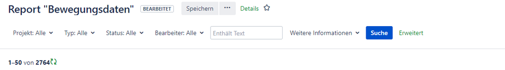

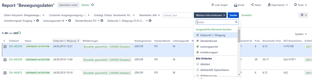

But in standard mode most of the fields are not shown in the UI:
Unbenannt.PNGThis makes the filter unusable in standard mode.
When i delete all filters that can be deleted using the mouse the standard mode looks like this:
delteted.PNGBut the JQL in the background is still filtering on some values

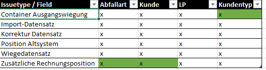

The Contexts had some missing combinations (marked in green)
These missing combinations make so sense for the use case, but it seems you have to get a full coverage over the issue types to get the navigator to work as desired.
