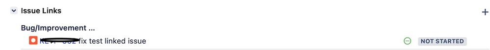

I have created a linkedissuetype, however, on a task, it does not display the entire name (Bug/Improvement ...). Is the reasoning because there is a character limit? Please see the screen shot below.

The link type is not just "Bug/Improvement" there is actually more to that title. Which is one reason I am wanting it to display the entire thing. We have a project for "critical" type tasks, but create a related task in other projects to fix the "critical" task. It is solely based on how we have set up Jira.

Yes, it does.  Two actually - one is the size of the column in the database, but that's longer than the "don't display over-long names so it all fits on the screen" limit.
