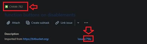

I just imported a issues from a repository in bitbucket throgh the "Migrate issues to jira software" button in the repository settings, and all the issue keys changed number, from bitbucket to jira. See pic. below
This defeats the whole purpose of our migration effort, so, can this be fixed so that the "CHAM-782" becomes "CHAM-794", and so on, for all imported issues?
(Keeping the same key nr. from Bitbucket to Jira.)

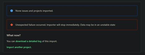

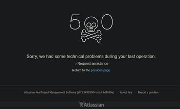

Currently in Jira Server, I go to System -> External System Import:
-If i select JSON file import, i get this
-If i select Bitbucket setup ->Grant Acess, i get this error

  4. When you try to import the JSON you get the error in the provided screenshot

  • Can you confirm you exported the Bitbucket issues to JSON from the repository settings and you tried to import them to Jira Server since this is not clear from your reply
  • In case you did export the Bitbucket Cloud issues to JSON and you got the error when importing back in Server, can you download the detailed log and see if there is any error in there (and in case paste it in your reply)?
