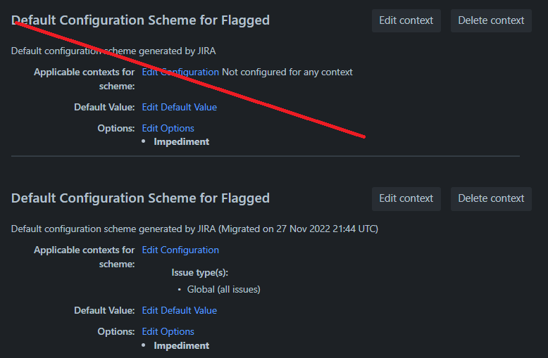

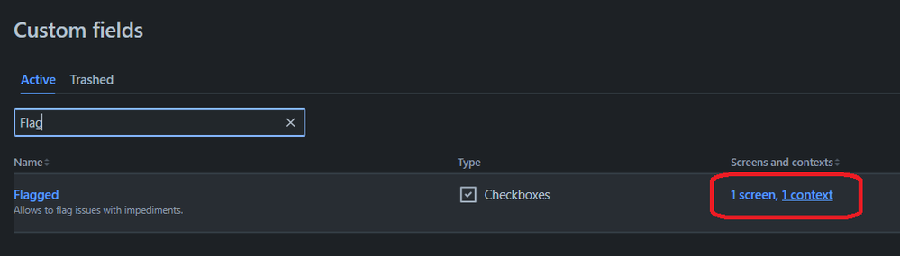

Vong Nguyen Tran
April 24, 2024
@Nathan Härdig @Iresh Rupasinghe
Check in the field configuration, if you see more than 1 context that are associated to Flagged, check and remove the redundant/wrong one.image1.pngimage.png
