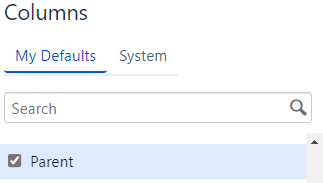

For those looking for how to show the epic name, the parent field can be used to show the assigned epic.

Thank you @Paul Argue you solved my issue :)
Go to Columns and select Parent to see Epic for each issue.

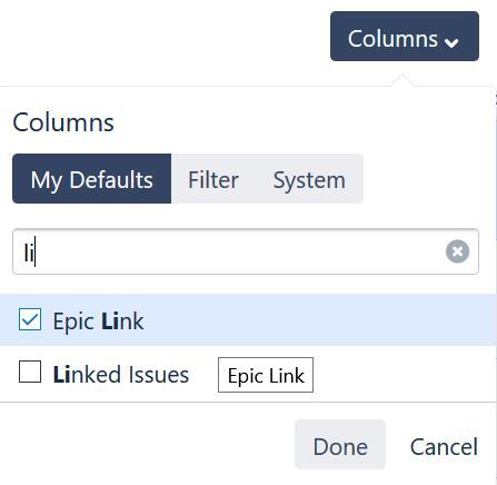

Go to Columns option near Search button on filter screen section and then choose an Epic Link value from the list like on attached screen.
thanks Michael -- it added another column, but still shows up as blank. Assuming it is the issue with Next Gen,
yes it is because u r on NG.
After adding the Column for 'EPIC LInk' on the Issue Search, the result just shows blank column. Is this a feature in the New Gen JIRA Project? Strange because it seems to have broken a simple and very important feature of being able to view the EPIC Link in the issue search. Is there a way to change a New Gen type of project to the older one?
@Harneet Singh , correct that is what this thread is saying. There is an article that explains how to change from NG to Classic but I don’t have it at my fingertips. You can search the community and find other threads that will point you to it. Basically it is a ‘simple’ matter of creating a Classic project and bulk moving issues.
