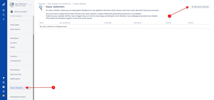

Then within the project settings you must go to Issue collectors >> + Add issue collector as shown in the picture:

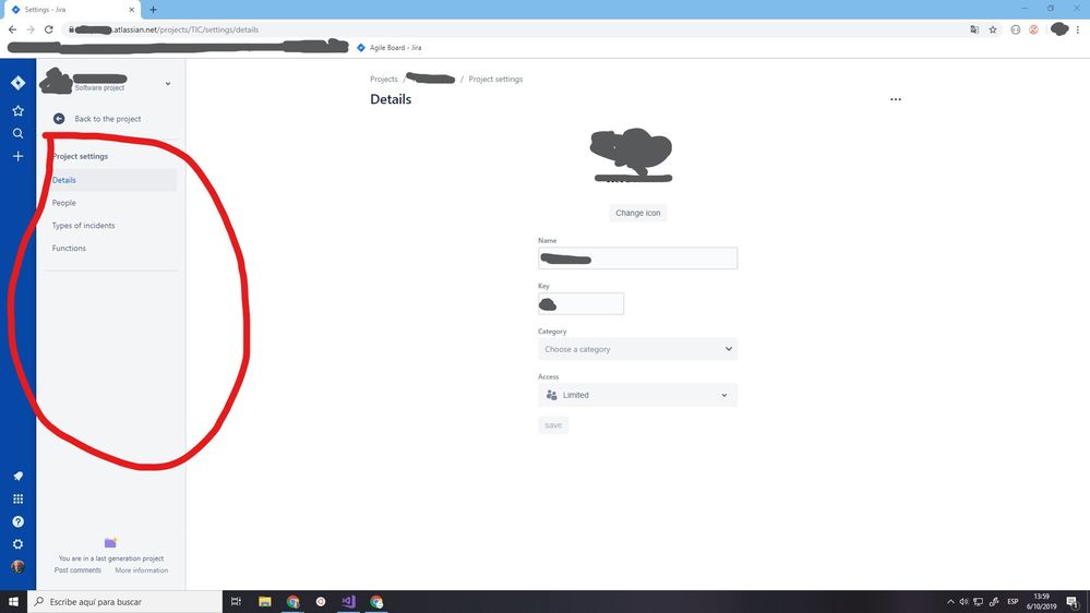

i'm a full right admin on my JIRA instance.  I leave a screenshot from my instance (sorry for  the childish style drawn)

Hi, I've updated my previous response to point out that this feature is not available on Next-Gen projects for now.
Is that your case?

Thanks, that was my problem. My proyect is next-gen type.
