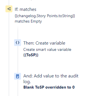

Lewis Cook
August 4, 2021
I've worked around this issue with the following:

Lewis Cook
August 3, 2021
Hi @Bill Sheboy ,
 Yep that is the scenario I am having issues with:
  1. Sub-task has story points
  2. Sub-task has story points cleared
  3. Automation fails because {{changelog.Story Points.toString|0}} returns a "" rather than 0
The reverse scenario works fine with {{changelog.Story Points.fromString|0}} returning a 0.
I'll probably take your advice on the support ticket.
I shall also take a look at LookupIssues as an alternate option.
Thanks
Lewis
