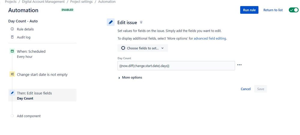

Capture.JPGhere is what I have so far. I would like this to recalc regularly so we can filter by the age of tickets. The "the change start date" selection should be stagnate once selected

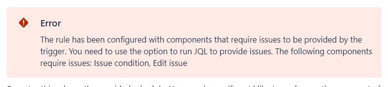

However, I can not get the rule to publish as I am getting this error:
Trudy P Claspill
September 1, 2022
Oh, right, yes, sorry. What was I thinking? :-)
The components you've selected are correct, but the way you are trying to reference the "Change start date" field in the smart value is not correct.
Do you get an error in the audit log when the rule runs?
Look at the format of the diff function:
{{[date1].diff([date2]).[unit]}}
...and look at other examples where [date] is part of the format and an issue field is being referenced.
First you need to tell it that you want to reference a field in the issue that triggered the rule, so you start with
issue.
Then you have to tell it what field you want to reference. There are a few ways to reference a field; by name or by ID.
(issue.Change start date)
You might also want to insert Log Action actions to log the values of fields and calculations into your rule audit log, to see what values the rule is working with.

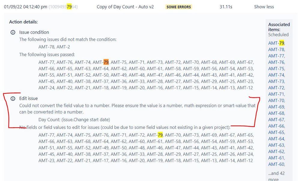

Thank you for the help. I received an error after running the rule, but I'm not sure why because Day Count (or age as we were previously calling it) is set a numerical values with a defaultCapture.JPG of 1.
Trudy P Claspill
September 1, 2022
@Jordon Martig
I think you might have misunderstood my previous post.
I was talking only about how you referenced the "Change start date" field within the smart value. You do still need the whole smart value with the diff function:
{{now.diff(issue.Change start date).days}}
You would get the error you saw if you are trying simply to assign the value of the "Change start date" field (a date picker field) to the Day Count field (a numeric field).

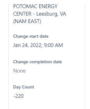

So the good news is that it appears to have worked. However, I got negative values. Thoughts?
Trudy P Claspill
September 1, 2022
That is explained in the documentation. Take a closer look at it.
