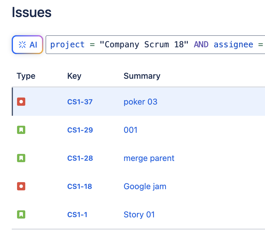

We logged the JQL query that our application uses to retrieve data, and as shown in the attached image, the query returned no results during the Marketplace review.
When we manually enter the same JQL query into the Jira application’s filter section, the expected data is returned correctly, as shown in the second attached image.

Hi,
The response you get from the Jira JQL search can be different than what you see on the UI if you are using asApp() in your API calls. App may have a different permission than normal Jira users.

Yes, I use the asApp() method for calls within the application. I will change these to asUser() and start the process again.
