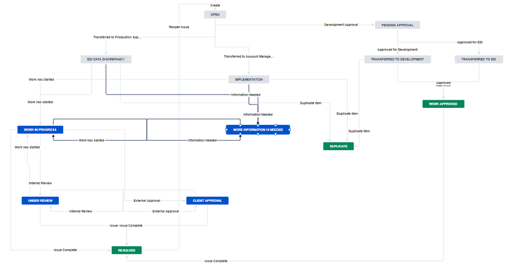

I have a transition called "Information Needed." I am removing it from one status, just one. The transition is still needed for other statuses. I can see that I can delete the transition, but it deletes the other "Information Needed" transitions. I am just trying to remove this transition from this one status, not delete the transition entirely. Is there really no way to do this? Is there a button I am missing?
Edit: Around this I just copied over the workflow, and removed the status. However, I am still curious as to if there is a way to remove a transition from a status without using a workaround.

how are you deleting the transition? can you share your workflow diagram? you should be able to edit the workflow in diagram mode and click the specific transition and then delete transition. Worse case, you simply add the transition back into the other statuses.
tmartin
March 18, 2019
I have added the diagram.
This issue is when I click delete, it deletes the other "Information Needed" transitions.

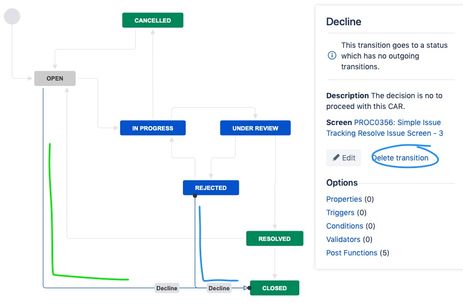

To be sure, are you selecting the transition into the status? I just tested on one of my test projects where I had reused a transition and was able to delete a single transition. I am on cloud.
In the image below:
  1. there are two "Decline" transitions (reused)
  2. I select the blue line and click "Delete transition"
  3. the green transition remains

Interesting. That is exactly what I attempted, however, when I use "Delete transition" it removes all of the identical ones.

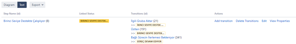

I have the same issue when i try to delete reused transition, it deletes all of the transition that i have used between different statuses. So to delete only the transition you choosed, you have to select the transition from text view of the workflow.
Go Administration -> Issues -> Workflows -> (Find your desired workflow) -> Edit

It works fine, thanks.
