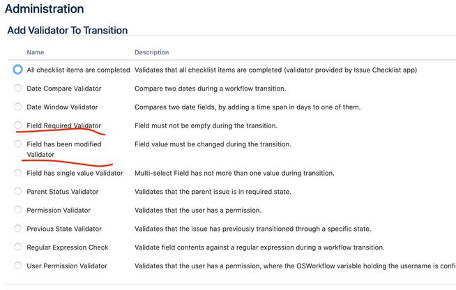

you can have a field required as part of a transition (unless you are using Next-gen projects in cloud). For classic projects:

project settings > workflows
edit the workflow, select the transition in question and click on Validator then add validator.

You will find the configuration of the Validators just next to the post functions.

No, without plugins you can only make a custom field mandatory in the field configuration scheme for a project, which applies to all screens.
If you just want the validation in a workflow transition, then only option is to go for add-ons like - Jira Suite Utilities.
