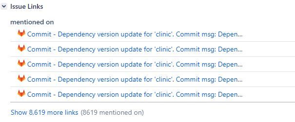

Hi, I wanted to delete almost 8000 issue links from my ticket. Is there any option to delete the links other than doing it manually?

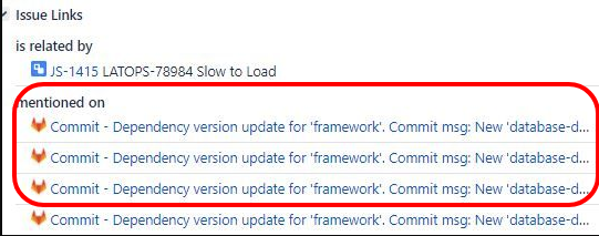

Hi @Ram Kumar Aravindakshan _Adaptavist_ ,Thanks for the script. But I still couldn't delete the issue Links
The issue Links are from the same issue. I have attached the image of the issue Link which still exist even after running the code.issue link.JPG

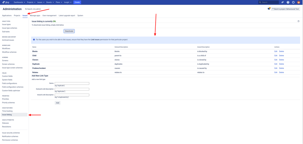

Also, could you please provide a print screen of your Issue Links configuration as shown in the example below:-

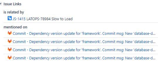

HI @Ram Kumar Aravindakshan _Adaptavist_ ,
Yes it is from one issue. we aren't aware of the issue link type and issue link configuration since it has been coming from Gitlab Integration. You can see the attached screenshot above.
Also I have tried with the code you sent it runs without any errors but no actions has been performed on the issue, The issue links still exists.

Hi @Kruthika R
As requested in my previous comment:-
Please provide a print screen of your Issue Links configuration. This is to confirm whether the links you have displayed on your print screen, as shown below, are provided by Jira.
If the link does not exist on the Issue Links configuration page, it cannot be removed from Jira using ScriptRunner. Instead, you need to remove it from GitLab.
FYI, a ticket for this has also been created on GitLab
