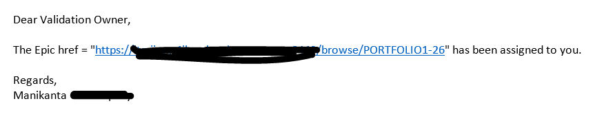

Thanks for the reply again.
I have added Email Template as below:
Dear Validation Owner,
The ${issue.issueType.name} href = "${baseurl}/browse/${issue.getKey()}" has been assigned to you.
Regards,
${issue.reporter?.displayName}
after updating the issue i got notification from Jira as below:
How can i replace Validation Owner name with the custom filed user name like replacing reporter name in Email notification?

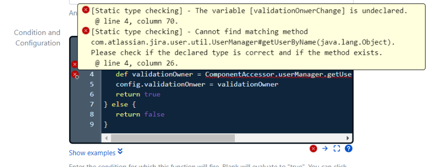

Looks like I made a typo ... make sure validationOwnerChange is spelled the same in all three places.
But you may still get a static type checking error. Those don't always mean that the code won't run. It's just the editor's type checker can't confirm the type of a variable to see if it matches the type the method accepts.
changed the validationOwnerChange name correctly in all places in script. Now i don't see "Variable undeclared error". But still it shows error "Cannot find Matching method".

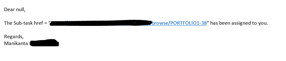

Hi Peter,
It is working after adding ? in the Email Template. I got notification but Validation Owner name in the notification is null.
That looks like it's might not be coming from the script, but from somewhere else in your configuration. Maybe the template.
Maybe confi.validationOwner was set to null. So you may need to trap against that.
I'm made some assumption in my recommendation. One of which is that the validation owner field is a user picker field and the changelogItem.newstring value is the username string for that field.
