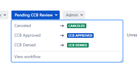

Can I rearrange the status in the dropdown menu in Data center using opsbar sequence settings? Is a higher number lower on the dropdown list?
10-20-30-40-50 is from left to right for the transition buttons on the issue view.
@Dave Mathijs but I have the dropdown menu
I want to put canceled at bottom of the list. I tried setting it to 90 which could put it far right or "bottom" no change.
@Carla Ann K. Rowland You indicated that you are on 'jira-server' which is a different issue layout than Cloud, my apologies for the incorrect answer.
Did you put a sequence number on all transitions? Each transition needs to have a sequence number, not only 'Canceled'.
@Dave Mathijs no worries; I will try in a little bit putting a opsbar on the other statuses--- its a long workflow. It won't be until tomorrow or next day -- I will post results here. Thank you.
Hi Dave,
I tested on a smaller workflow and when I assigned values to the other statuses it worked. Thanks for the reminder... just juggling a lot with my instance.
