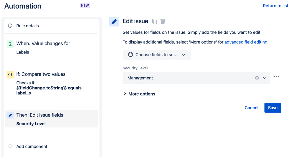

Oliver Siebenmarck _Polymetis Apps_
May 11, 2023
Hi @Jared McNeil ,
Certainly is! Automation is a truly amazing feature. The trick here is using smart values to check the change to the label field. Admittedly, I have not test this yet, but the following should work:
Of course, you'll need to create the required Security Levels for your project, so that you can set them; Jira does not ship with a default setting.
Hope that helps,
