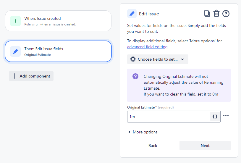

Hi Jon,
Thanks for answering my question and for sharing that feature.
Do you know if there is way to also create this same automation rule to already created (existing) Jira issues that do not have an original estimate field filled in yet? I could not find a way to accomplish this.
