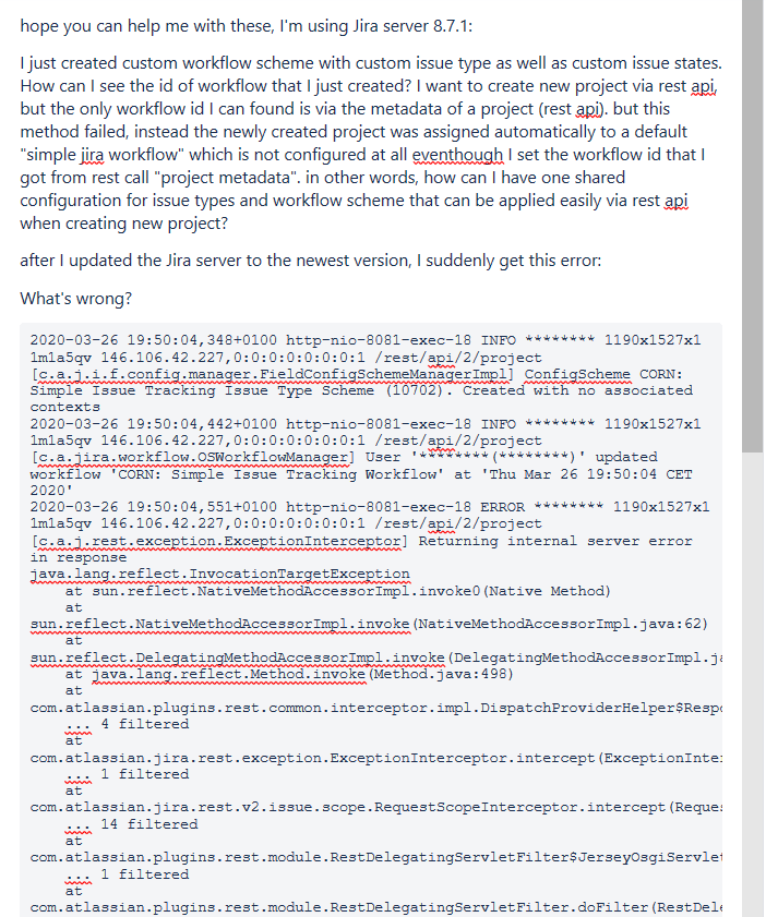

A S
March 26, 2020
Hi @Petter Gonçalves
I tried to comment but it failed, instead I used a screenshot below
