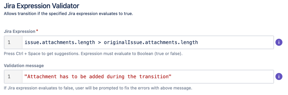

I don't think there is a way in Jira out of the box. However, with any jira expression based validator you could validate if the attachments were added during the transition. You can search for apps providing jira expression validator on the Atlassian Marketplace
I am from Forgappify, and we also developed Jira Expression Validator, which is part of the Workflow Building Blocks for Jira
For your case, the Jira expression would be as follows:
Or you can test the difference:
issue.attachments.length - originalIssue.attachments.length == 2
where "issue" is the snapshot of fields including those from transition, and originalIssue is a snapshot from before the transition.
I hope it will help.
