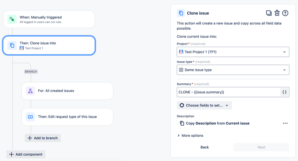

So if I understand you, when the request ticket reaches a certain step in the workflow (i.e. status) then the issue should be cloned into the engineering project. Correct?
If so, you can create an automation rule based on an Issue Transitioned trigger. Choose the status that it is transitioning into.
Then add any Conditions about the request ticket if needed/desired.
Then add an action for Clone Issue - be sure to change the Project to reflect the one it is going into.

There's actually a Clone issue action in Automation.Screenshot 2024-07-05 at 09.11.49.png
And, there's also a Move issue to board action too that is specific for Software projects. Try playing around with Automation, it might help you with your requirements here
