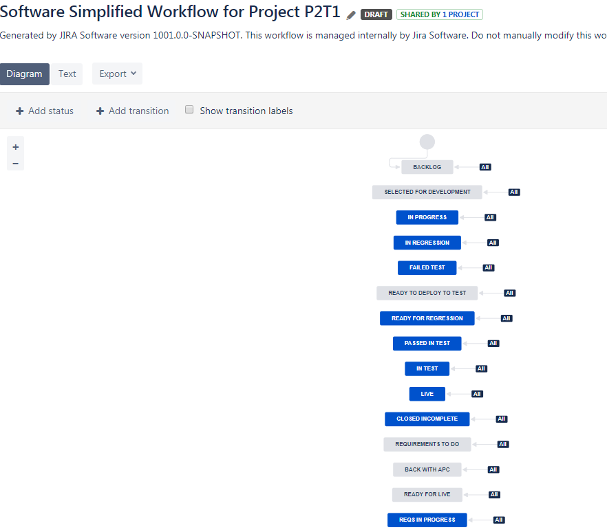

Here is the workflow, as mentioned before a warning message shows not to edit the workflow.
all Statuses have a transition from ALL.

Hi Tuncay, thanks for your reply
I think it's because I am using a basic workflow where all statuses can transition to any status.
i get this message when i am trying to edit the workflow:
Generated by JIRA Software version 1001.0.0-SNAPSHOT. This workflow is managed internally by Jira Software. Do not manually modify this workflow.
I may need to create a manual workflow, unless there are any other ideas?
