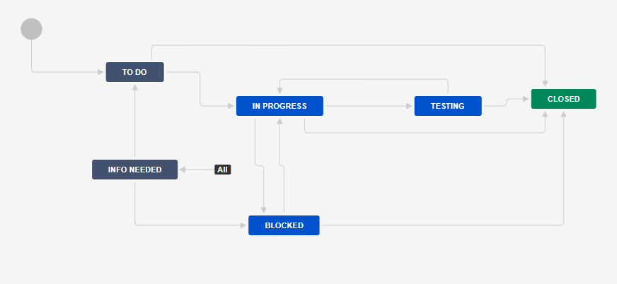

@Ste Wright So to understand correctly I have couple of questions:
In the first rule, then the transition goes from any previous status to my target status, we save the previous status to the custom field, right? That is OK. However, on the second rule you posted above. you have this:
  • Trigger: Field Value Changed
    • Field = <Field Here>
So are you expecting that the user changes other field? In my workflow the issue is sent to a Need info status, the person providing the info will add a comment and the idea is to send it back to the previous status when she clicks on Info Provided as part of the workflow buttons. I am not changing the custom field in any screen, so I would expect the trigger of the 2nd rule to be the transition out of my current (Info needed status), so then I would read the custom field value and apply it to where I want to transition to (the original status before sending it to info needed)
Can you clarify the behaviour of the second rule and  how are you reading the previous status from the custom field?
I pasted the workflow below. So for example if I am in Testing and do Info Needed, once I transition out of Info needed I want to go back to testing , with the automation I am getting an error: "No transitions to specified status could be found for issues (with current status):
TEST-768 (To Do - 10000)" so do I need to have transitions to from to do to everything? it does not make sense.
Ste Wright
January 20, 2023
Hi @Miguel Rodriguez
I made some assumptions about what the Triggers, etc would be - but this is still just an example. You can set the Trigger in Rule 2 to be anything you like.
Although I'd probably recommend it isn't a "Transition Issue" Trigger - that seems counterproductive. For example, it could be based on the Comment itself, as long as it is from a specific user (Reporter, etc).
In terms of transitioning to the previous Status - yes, it needs to be possible to go directly from Info Needed to any relevant Status. If the transition is not possible, the Automation will fail.
Your current Workflow would not support what you're looking to do using the Automation Rule above - you'd need multiple IF/ELSE Conditions, and multiple transitions to get back to "Testing" (for example).
I'd strongly recommend making all Statuses "All" for transitions, if this is an option.
If you'd like more specific instructions, can you let us know...
  • The exact process these Issues would go through?
  • If making the Workflow more open is an option?
Ste
Like • Miguel Rodriguez likes this
Miguel Rodriguez
January 20, 2023
Hello @Ste Wright thanks very much.  Based on the error I was getting, I assumed what you confirmed, I need a valid transition to get to the original status, but I would not like all to all because there are some cases where we want to have a sequence of events, specially for some other more complex workflows. I am going to look at them and see if there is  compromise between a bit of controlled sequence and a flexible return to previous status can be done. Thanks for all your help and clarifications Stephen.

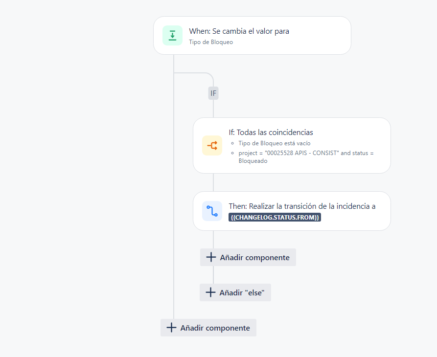

carlosmestanza
September 9, 2024
Hi, this is my automation and dont work for me. Please can you tell me what im doing wrong?
Thanks

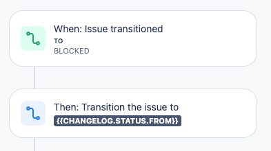

Asela Jayasinghe
March 5, 2024
Hi Miguel Rodriguez
The easiest way to do this is using {{changelog.status.from}}  You do not need any custom fields. I have Jira Cloud and it works perfectly.
Example
Asela Jayasinghe
March 5, 2024
 {{changelog.status.fromString}} will give you the actual status in text. However, you can't use it for transition. It will give you error "Destination status could not be resolved. If using a smart-value ensure this resolves to a numeric status ID or untranslated name for issues (with current status):
You have to use the number of the status and it comes from "FROM".  Try adding an action  to comment on issue {{changelog.status}}  it will show all the available values
Example
ChangeItemBean{fieldId='status', field='status', fieldType='null', from='13961', fromString='In Requirements', to='11200', toString='Blocked'}
In this case "In Requirements" status = 13961 and that's the value it will derive from  {{changelog.status.from}}
Like • Xurxo García likes this
