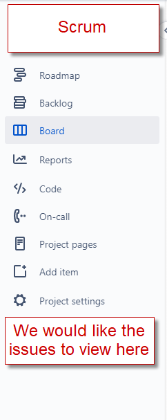

I'm asking as our team would like to view their issues as is done on the Kanban board.

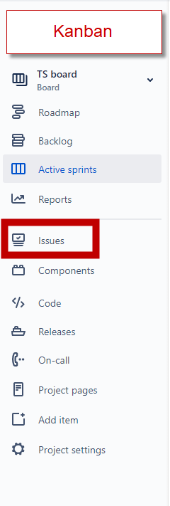

I see the Filters on the top ribbon always and yes, we can use it to find what we are after. But on the Kanban board, Issues is on the left tool bar for the specific project board.
It works well and has All issues, My open issues, Reported by me, etc. already sitting there with drop downs so you don't have to leave your board and select filters from the top tool bar. Can 'Issues' not sit on the left hand side with a drop down? Are there simple instructions anywhere?
It could be perhaps that I have the board set up as a team managed board and should be company Managed instead or something tricky like that??? Maybe my mock up below will give some clarity.

Go to Project Settings > Features and see if the "Issues" selections is turned on.
These two images you pasted here, is on the same project?
joe stewart
August 3, 2021
Your instructions are perfect Alex. I have now added it to my tool bar. Thank you so much!
