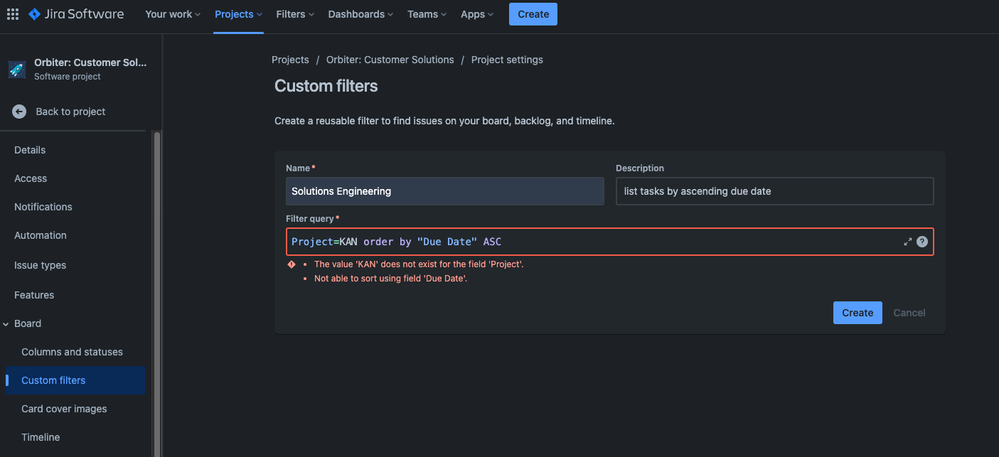

I am getting this error
Tina Au
September 26, 2023
Nic Brough -Adaptavist-
September 29, 2023
This suggests that you do not have a project with a key of KAN.
Try typing the query from scratch - when you start to type KAN, Jira will start to offer you valid project names.  (Also try that for the due date part)
