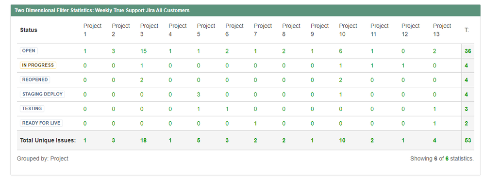

Is there a way of grouping status on the two dimension filter statistic gadget?
Paula Lyon-Lee
October 12, 2023
But I want it to add open, in progress and reopened together so that there is 1 value instead of 3 and the same with Staging deploy testing and ready for live.
for example
Status    Project 1   Project 2   Project 3 etc
Open       1                3                 18
Server      0                0                  0
totals      1                  3                18

Hi @Paula Lyon-Lee
That is not possible with the built-in gadget.  The Atlassian Marketplace may have a gadget for purchase to do so...or...
A work-around would be to:
  • add a single-select, custom field to summarize/roll-up your status values
  • add an automation rule to set the custom field when the issues transition status
  • change your gadget to report on the custom field
I recommend discussing this with your Jira site admin first, as adding a custom field for this type of reporting may not be ideal, and the marketplace option could be better.

Hi @Paula Lyon-Lee
This is not possible using the default jira gadget, you may want to look for some marketplace app which will allow you to do so.
