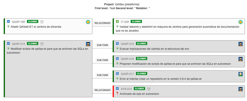

I have tested a plugin called TraceabilityX by excentia, which is actually wonderful. It does precisely what I need however with one major flaw:
It can only visualize two levels and I need to visualize three levels. However the way it is displayed is absolutly perfect. (The picture is actually from the traceabilityX doc and it perfectly shows what I need.)
Can you guys recommend me a similar plugin, that can actually provide clear visualization of three levels of issues?

What I liked about TraceabilityX is, that I could tell it: Please show me all Requirements-tickets with every linked issue.
