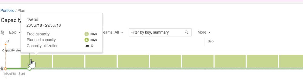

I am referring to the capacity on the timeline.  On the image below..
I have 2 stories
1st  story estimate = 7 days
2nd story estimate = 1 day
2 team members each 40 hours (5 days) /week.
Question:  how is the free capacity and planned capacity calculated?

Hi Juanita,
Thanks for the screenshot, and it looks like there is a bit more data behind the scenes coming into play.  The capacity itself is going to have quite a few reasons that there is Free capacity left over.
The main thing to consider is that the scheduling algorithm believes there is nothing is able to schedule at that point and I would recommend looking at the Scheduling behavior and where the issues are scheduled, noting the factors:

Additionally as covered in that doc take a look at the Scheduling factors on each of the issue to find out why the issue is located where it is in the timeline,  I would guess that there is a dependency or earliest start date or a release set on an issues with a fixed start date, and possibly logged work and one of these items is pushing issues further down the timeline and/or removed some capacity on the logged work items.
Next check the estimation for logged work associated to some of the issues, as the issue may be in the appropriate sprint location but have work logged against the issue and therefore the Estimate is burned down but still on the schedule, so as an EXE with a similar setup, the following has a dependencies of FP-1 Blocked by FP-2, & 7 hours logged on FP-1, and an earliest start date on FP-1 pushing the highest ranked issue out to sprint 15 adding in the large gaps on free capacity and the logged work:
So how is your Schedule and Scope laid out on the plan? Primary things to check, where are the issues associated to each other in the schedule? Also what does the estimation and logged work look like on these issues? are there values on Earliest stat date, dependencies, or Releases associated?
