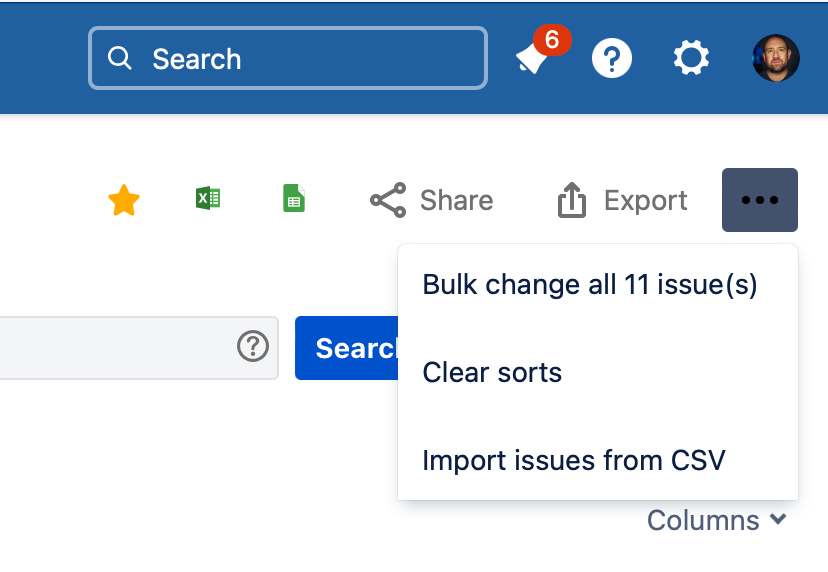

Hi @Jonas Stenberg ,
@Jack Brickey's answer is still valid, however the Bulk change option is a bit hidden. When you have a filter open, it's in the three dots menu on the top right like this:
Hope that helps,
 Oliver

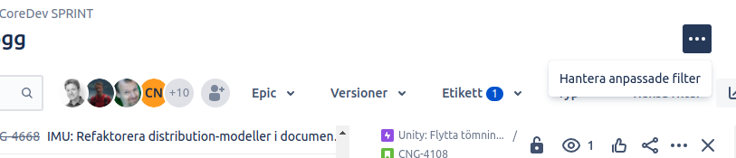

Jonas Stenberg
May 2, 2022
That is not how it looks like for me. Am I lacking some credentials or are we using a different version of Jira?
It is all in Swedish for me but I guess you can figure out what it means anyway. The only option I have is "Handle custom filters"
Like shacharoz likes this
Jack Brickey
May 2, 2022
@Jonas Stenberg ,
that image seems to be from a board maybe? You need to be on the Advanced issue search.

Jonas Stenberg
May 2, 2022
That is correct. I was in the backlog-view. Now I found the feature to bulk-edit in the advanced search. Thank you.
