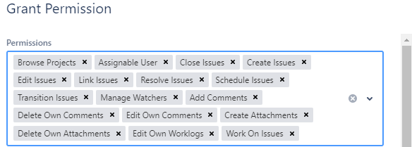

I need to provide access to an integration contractor to a Jira project, and the project admin would like the contactor to access only the ticket that the contractor himself creates and be able to do most things on the ticket.
I created a separate issue security level with "Contractor" and "Organisation", and granted most permissions to the project role (contactor), but this role doesn't have the "Set Issue Security", since I thought this would allow him to modify the issue security.

Does this mean I should give the contractor role "Set Issue Security" permission? And since the "Org" issues shouldn't be visible to him, he would not be able to modify the Issue Security Level anyway?

The permission is typically reserved for people who should have the ability change/set the security level for an issue. For a user that has that permission, they can only select from the security levels to which they have been assigned.
So, if you want the Contractor to be able to set the security level to Contractor for issues that they are creating, you will have to give them permission to set Set Issue Security.
Alternately you could use an Automation Rule to detect new issues created by Contractors and use the rule to change the Security Level to Contractor for those users. The Actor set for the Automation Rule would have to be a user that has the Set Issue Security permission for the project and is a member of both the Organization and Contractor security levels.
