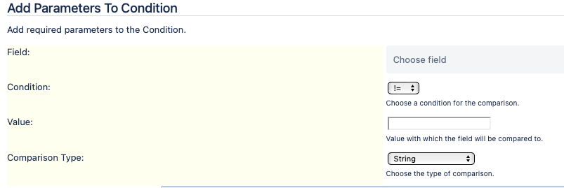

Hi @Tiago Machado
you can set a Condition on the workflow transition to check a field value
Do you need more detailed info?

Right, that would prevent the transition, but is the user warned about that? That a certain condition for the transition was not met?
Tom Lister
October 31, 2022
Hi @Tiago Machado
A condition won't warn the user. The option to use the transition won't be shown if the condition fails.
Validators issue warning but there is no option to check a field value in the basic workflow options.
You other options would be left with looking for a plugin to support this such as scriptrunner or Jira Misc Workflow Extensions.

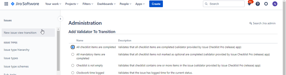

Adaeze_Jude_HEROCODERS
November 2, 2022
Hi @Tiago Machado
I am Adaeze, a Herocoders Support Specialist.
You can achieve this using our App Issue checklist PRO or Issue checklist free.
Issue Checklist provides you with in-built validators that can be used to stop transition if checklist items are not completed(marked).
To set up this Validator:
  1. Navigate to Project settings > Workflows.
  2. Clist the pencil icon to edit the workflow.
  3. Select Diagram mode and click on the transition where you want to add the Validator.
  4. Click on Validators and then click on add validator.
  5. Select the appropriate validate and then click Add; as shownchrome_0yCeu8CdOy.png
  6. Click Add again to confirm the creation of the validator.
  7. Click publish draft to save the changes.
  8. Test the validator by attempting to transition an issue that does not meet the criteria, and the transition will fail.
Please see our documentation for further details on how Validaors work.
