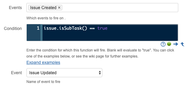

You can use ScriptRunner Listener function:
1) Create listener for Issue Created event
2) Check in event if created task is a sub-task.
3) If so, update parent.
Or you can use some other plugins discusses here: https://community.atlassian.com/t5/Jira-questions/Can-I-copy-a-field-value-from-sub-task-to-the-parent-issue/qaq-p/64798
Ronen Erlich
August 6, 2019
Screen Shot 2019-08-06 at 11.01.11 AM.pngabove is a screen shot of all the steps 1-3. my problem is that the event available to to update the issue not the parent. Does anyone how I can I update the parent? what I have above just update the subtask I believe...
I have a behavior that sum values from subtasks and show as a field on the parent. currently i need to edit and cancel the parent to get it updated...
thanks,
