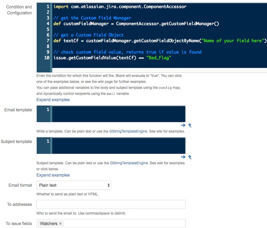

You should be able to do this fairly easily. You could set up a script listener that responds to "Issue Updated" events. In the condition of that script listener, check to see if the custom field value is "Red_Flag":
import com.atlassian.jira.component.ComponentAccessor
// get the Custom Field Manager
def customFieldManager = ComponentAccessor.getCustomFieldManager()
// get a Custom Field Object
def textCf = customFieldManager.getCustomFieldObjectByName("Name of your field here")
// check custom field value, returns true if value is found
issue.getCustomFieldValue(textCf) == "Red_Flag"
Remember to change the script and put in your custom field name.
If the custom field value is "Red_Flag" the condition will return true and a custom email will send. You can set the "To issue fields" to the "Watchers" group so that it goes to the Watchers only.
