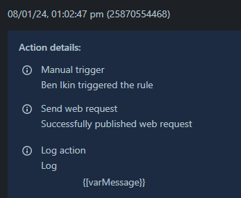

{{#issue.comments}}
{{#if(equals(body.match(".*(React).*"),"React"))}}{{body}}{{/}}{{^last}}, {{/}}
(I also tried with just {{#comments}}
3. I have created a step to add value to the audit log, using {{varMessage}} as the value.
4.  On reviewing the automation audit log, I am able to see the following:
I'm definitely missing something but struggling to identify what exactly as this stretches beyond my knowledge (and I'm happy to be learning!)
Could it be as a result of the rule returning more than 1x value to start with? I could adjust this down to specify a particular issue if that would be helpful.
Bill Sheboy
January 8, 2024
Hi, Ben...happy new year!
If you review that audit log, you will see a typo when you write {{varMessage}} as there is a square bracket in there.  Please correct that and then re-test.  Thanks!

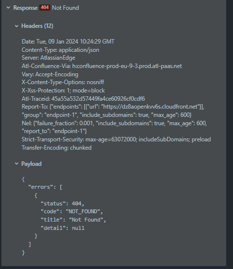

Only problem that I'm facing now is that the code previously working is returning a 404. I've gone back to a previous known good state and the same happens. I've even gone back to basics where no data is posted (simply create a page) and returns the same error. Have you seen this happen before? Seems to be being blocked now?
Bill Sheboy
January 9, 2024
I've seen that when my URL for the service is incorrect, or there is an outage on the receiving side.
I recommend diagnosing that symptom separately, such as calling the service with a mechanism outside of the automation rule.  That will help fault isolate it, and once it is working again, return to testing with the rule.

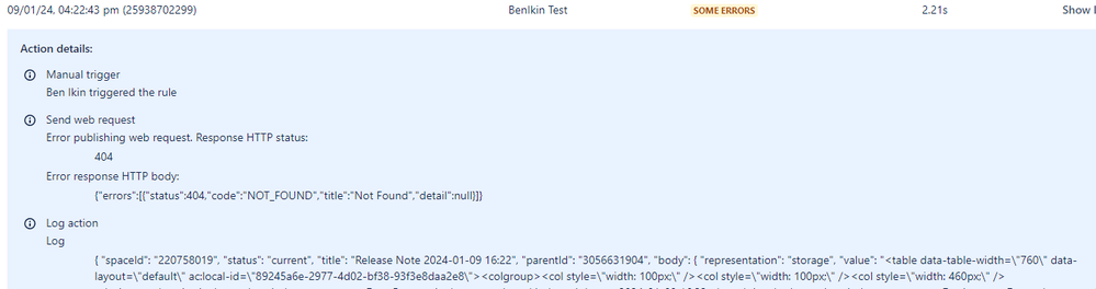

Did you try writing that request to the audit log to review it, ensuring it matches what you expected?
Ben Ikin
January 9, 2024
Yes, it still returns a 404 error in the POST but in the audit log I can see the data that I'd expect to see, including the searched for comments.

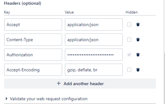

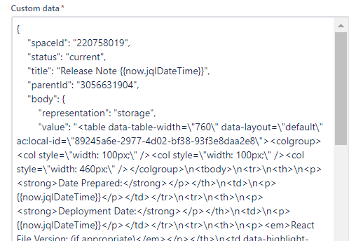

Nope nothing whatsoever. The configuration hasn't changed since we started, where it was working. The only parts that have changed are the custom data parts within the body of the request, and even going back to basics there doesn't resolve the issue. The same URL, headers and data work via Postman and leave the values written rather than return the values but I'd expect that. My next step will be to create it from fresh.

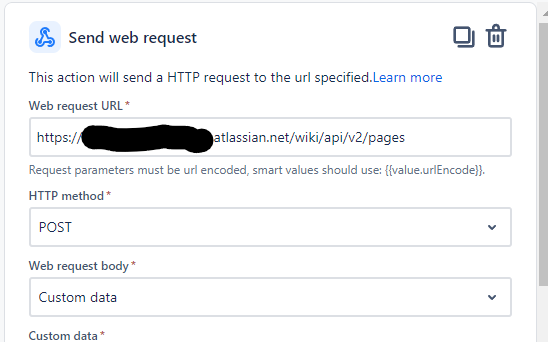

Here's some screenshots of the configuration.
Screenshot 2024-01-09 170341.pngScreenshot 2024-01-09 170320.pngScreenshot 2024-01-09 170151.png
Bill Sheboy
January 9, 2024
I wonder if the call is encountering this defect, where using the content-type key is causing a duplicated header: https://jira.atlassian.com/browse/AUTO-98
Do you have logging on the receiving side to check the sent calls?
