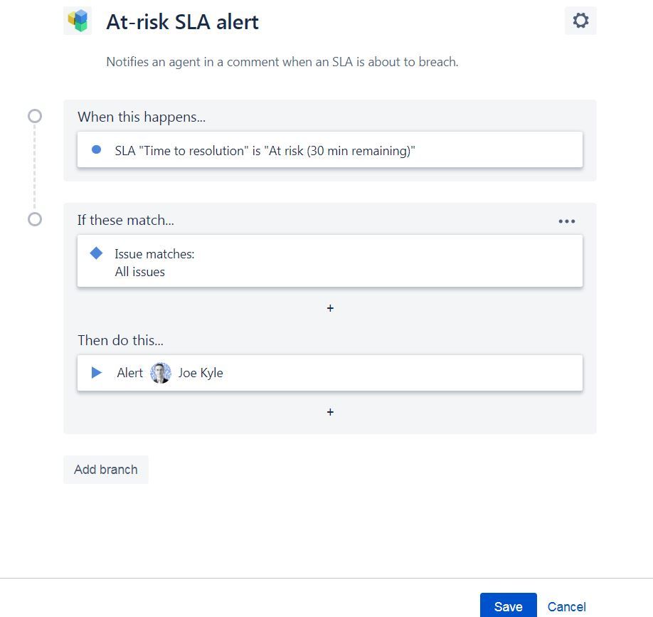

Hello Francesca,
One way to do this is to add an automation rule. You can find "Automation Rule" on the left-hand (Dark Blue) navigation menu within the project you wish to set the alert for. Note this will only set the SLA alert for issues coming from that project - not all projects.
