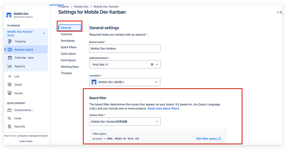

Hi @[deleted]
Welcome to our Community.
Please make sure your board filter includes the sub-task issue types.
Thanks,
YY Bro

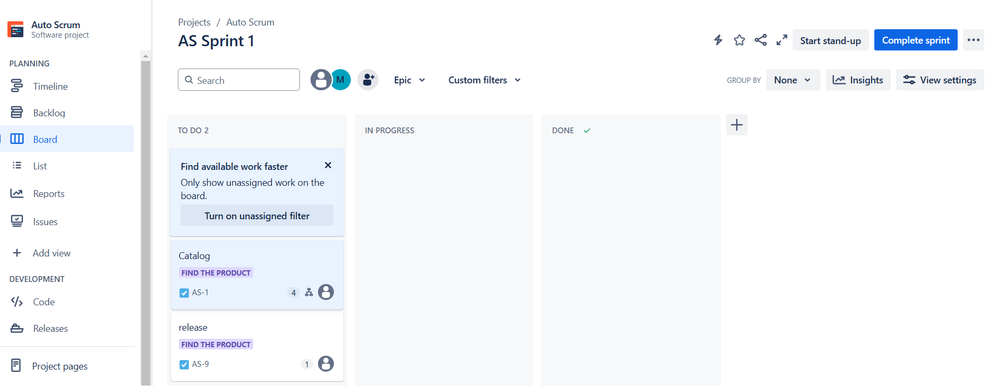

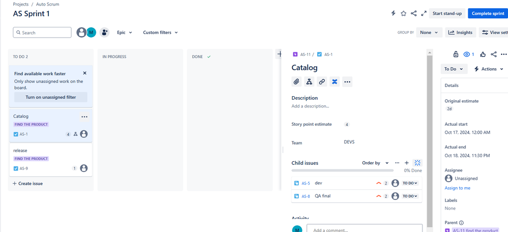

screen 1 - this is my board, I have two sabtasks in the task "Catalog". I want to see these subtasks on the board.

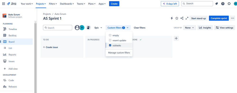

so when I've added the custom filter for the subtasks I still can't see the subtasks on the board.
screen 2 - I still don't see the tasks :(

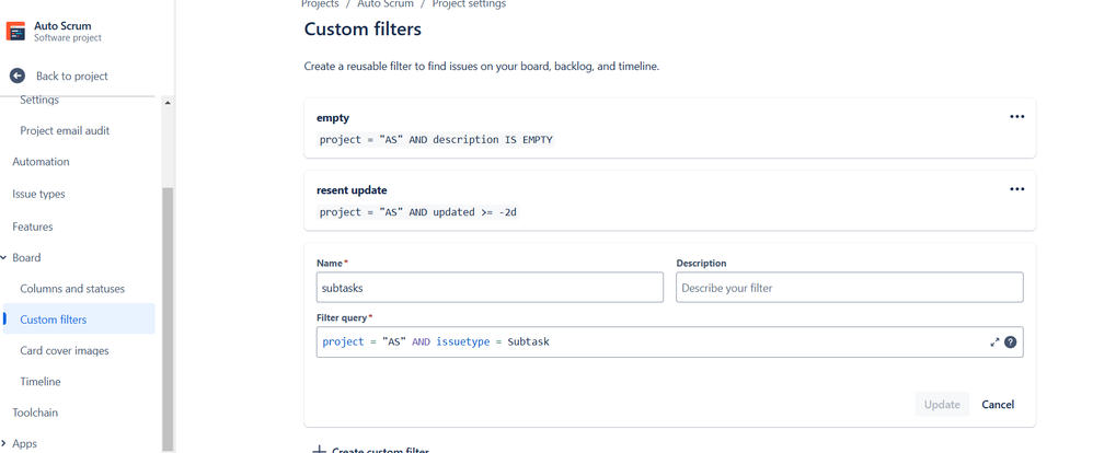

Here is the query filter settings
screen 3 - filter settings

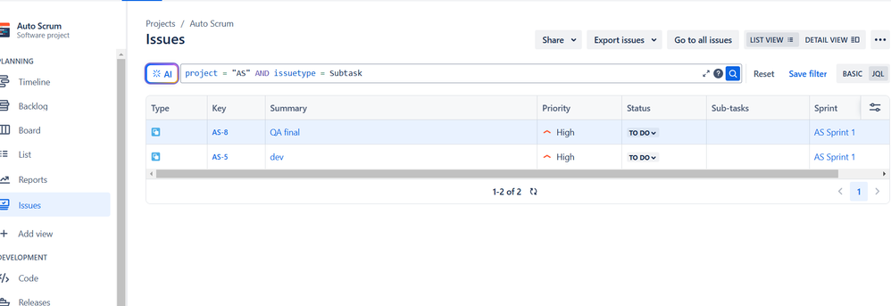

here is the lists of the subtasks that I want to see on the board
screen 4 - the same filter on the "issues menu"
