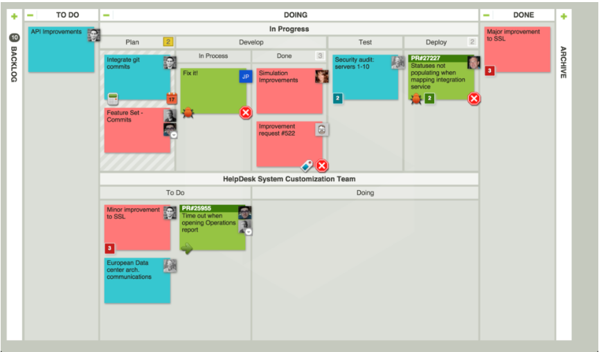

I'm looking to migrate from a SaaS Kanban solution and have a license for JIRA and JIRA Agile.  One feature I can't seem to find is the ability to set different columns for each of the swimlanes on the board.  That is, each swim lane refers to a particular process, and each of the columns refers to a process step; hence it follows that the process steps (columns) would be different for each of the processes (swimlanes).
This is a feature that does exist in the other solution I'm using, so I'm not sure if it just doesn't exist in JIRA Agile or if I just don't know how to use it.  I searched Atlassian's site and read just about every article on Swim Lanes and Columns, and I still can't seem to find it.

Sorry Nick,
they don't. I've seen plenty of posts asking for fairly basic things that are getting no traction or require the user to add expensive plug-ins (e.g. color the whole card, export state transition data, etc.).
And, I'm sorry, but even David Anderson would laugh at the notion of 'pure kanban'. There are some general principles and practices (here http://www.djaa.com/principles-general-practices-kanban-method). Two of those are "visualize the work" and "make processes explicit", which means there are no wrong processes, there are simply the processes you have and the processes you evolve to.
Having this flexibility becomes even more important with large-scale or portfolio kanban. Is there an architectural or design issue that is stopping Atlassian from providing this flexibility?
Here's one from Leankit, who do get it right https://leankit.com/learn/kanban/kanban-board-examples-for-development-and-operations/

Maybe swim lanes wouldn't be the right way to accomplish it. Here's the problem...
I have one process, say a development one, that goes Analysis, Development, Testing, Elevate, and another process say for general tasks that is Analysis, Implementation, Done. So I want the board to show 4 columns for the development process and 3 columns for the general task process.
The other tool I currently use reflects this with different columns for 2 swim lanes. That is, in one board, there is a 4x1 grid and a 3x1 grid, reflecting columns by lane.
Nic Brough -Adaptavist-
October 26, 2014
Hmm, that's an odd approach, you might as well throw away the boards if you're going to do it that way, as you probably should be doing the processes separately for each type of issue. Jira Agile won't do this. A column is a column, that's it. A column represents a collection of status (often just one). The closest you can get is to simply look at the project and issue type, because that will tell you which workflow an issue is following. Of course, you could then use those as swimlanes, so you have a swumlane for each (you define a filter for each), but you'll find it looks very odd, because a board is usually expected to group things together, not re-separate them!
